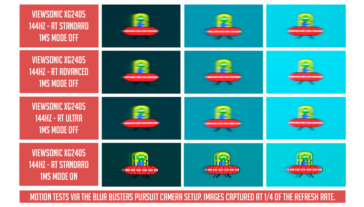

                                    Just to note a couple of things:
                                    1) A user emailed me a link to some pursuit photos from the website ‘TechPorn’ for the AOC and ViewSonic which shows the similar performance of the two or possibly even a minor edge to the ViewSonic in that test. There are other transitions to consider, especially with very bright or very dark shades where things could diverge more. But I don’t think you should expect any major differences in pixel responsiveness between the two products really and that isn’t something I’d put too much weight on when deciding between the two.
                                    2) This is complicated by the fact the AOC now uses a BOE-based rather than Panda-based panel. And it appears other models using that Panda panel are also switching or have switched and this might include the ViewSonic. Especially as this points to the Panda panel possibly being discontinued. The BOE panel seems to be very responsive, but contrast isn’t as high is it was on the Panda panel. Regardless of panel used, the main difference most will appreciate and notice between the 24G2(U) and XG2405 will be in its colour output and in particular the gamut – it’s very different and completely changes how shades are represented.
