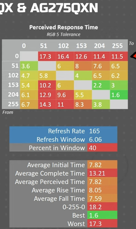

      @ PCMuser Dimming is really distracting at 165Hz to 75Hz.
      https://youtu.be/X_mVqSWvsow?si=LftKF28yGTLOOdjd
      On this video dimming look much worse than what I see personally. I think my camera isn’t good enough to capture this properly.
      I tried Twitter website with dark background and again 165-75Hz grey text is dimming.
      I didn’t notice this problem straight away because I focused to much on UFO test, gamma shift and viewing angles, and I was only testing white text on black background.
      With overdrive ‘strong’ this dimming is gone even at 165Hz, but replaced with overshoot. Now grey text is getting brighter when you move the window. 😉
      Adam should know how Samsung Odyssey Neo G7 handle this dimming situation.
      I feel like fast VA panel even this one from AOC, but with variable overdrive, or better tunning should be able to eliminate this problem.

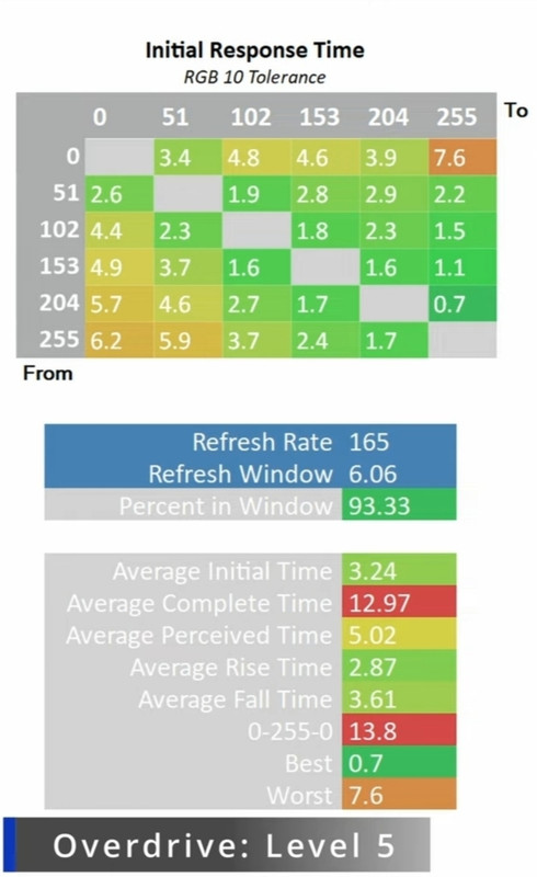

      Also Iiyama GB3467WQSU should be much, much faster than the AG275QXN.

        That’s a good demonstration of the darkening effect (and potential flickering with certain movement patterns). Whilst the Neo G7 wasn’t perfect in that respect, it was more subtle than that for sure.

          I think that Va panel almost need to have tiny bit of overshoot to compensate for that darkening.
          Medium overdrive in this AOC isn’t aggressive enough. Even at 60Hz there is tiny bit of that dimming visible on Twitter website, where my Sony VA TV doesn’t have that at 60Hz.

            I agree, they need to apply selectively aggressive acceleration to speed up the slowest transitions (inevitably giving some overshoot), without ‘over-accelerating’ other transitions. This naturally works best if the panel itself has at least a decent level of responsiveness. Some are beyond help and will either give obvious ‘smeary’ trailing or overshoot, regardless of how well-tuned the overdrive is.

              There is good test for that dimming behaviour on
              testufo.com
              Just experiment with ‘Pixels Per Frame’ speed. For me on AG275QXN at 165Hz even with slow speed vertical line almost disappear completely.
              #74796
                Ah yes, good call – medium grey against a black background will be perfect for demonstrating this. 🙂
                #74797
                  Actually it’s medium any color 😉
                  I tried all medium shaded and for example 140,0,0 dims the same.
                  Monitor is already in the box, but last night when I was testing that Twitter page it was actually funny to see only location icon to dim and flicker because it’s medium blue.

                    Well yes, “medium grey” in the monitor world refers to a medium grey value, which could indeed involve a medium intensity of R, G or B (or some mixture of those). Not literally a ‘colourless’ grey shade.

                              @ PCMuser No problem mate. At least i have learn something new, that UFO test isn’t enough to test pixel responsiveness.
                              With Iiyama GB3467WQSU looks like they pushed overdrive to the limits, but still it isn’t variable, so that means you have to tweak it for different refresh rates, and it’s also problematic for VRR.
