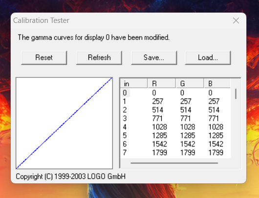

                      I correct myself. Windows color profile loader does not work well here even if I followed your guide.
                      I can see it by naked eye but I have a tool that tell me if the profile is correctly loaded or not.
                      At boot no profile is loaded:
                      no profile
                      If I open windows settings, the profile is immediately loaded:
                      https://i.postimg.cc/T3n34Nkc/windows-profile.png
                      but it is less accurate than if using the displaycal profile loader:
                      https://i.postimg.cc/RFZCqSvP/displaycal.png
                      I would say that the windows profile loader is completely broken, this is why most of the calibration software bundles their own profile loader.
                      am I wrong?
                      is there a way to fix this?
                      #75582
                        Sometimes there’s a slight delay in Windows loading the profile or you may need to open up a program. I haven’t had any issues myself using the method described in the article. I also like to use the ‘DisplayProfile’ utility mentioned in the article to double-check the profile is loaded. This will also correctly apply any profile selected. I personally spend most of the time without ICC profiles in use and load them for specific purposes as a reviewer, so I don’t really have an issue with how it works.
