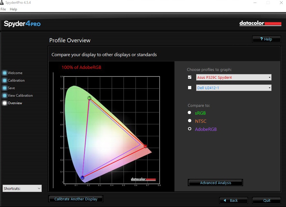

WallyHi everyone,
I have the PA329C since yesterday. Reading this topic helped me a lot making an decision. Thanks for that.
Already put a Spyder4 on the screen which shows it has full Adobe RGB coverage:
December 6, 2021 at 9:05 am #66923
PCM2I’m glad you find the thread useful and that you’re getting such a generous colour gamut. What is the coverage like with the emulation modes of the monitor (‘sRGB Mode’, ‘Adobe RGB Mode’ and ‘DCI-P3 Mode’) and does that lock off colour channel adjustments? Your feedback on the monitor is appreciated. 🙂

WallyIn the emulation modes the PA329C will only cover the colours within the selected gamut mode.
Also some settings are locked in the emulation modes. Depends on the mode:
In sRGB mode all colour setting are locked.
In aRGB only ‘Color Temp.’ and ‘Gamma’ are locked.
In DCI-P3 mode ‘Gamma’ is locked and in for the colour temperature you can choose between 6500K and something called P3-Theater (for people who like a green colour cast).Black level is, as expected from a edge lit IPS display, not really good. didn’t measure it, but it looks the same as my Dell U2412M (set at the same brightness).
In all other aspects it is a big improvement over my old monitor.One minor setback. My graphics card only has, next to a DVI and HDMI 1.4 port, two mini-DP ports. Mini-DP cable was of course not included in the box.
So until those cables are delivered I have to work with 30p.December 7, 2021 at 9:04 am #66931
