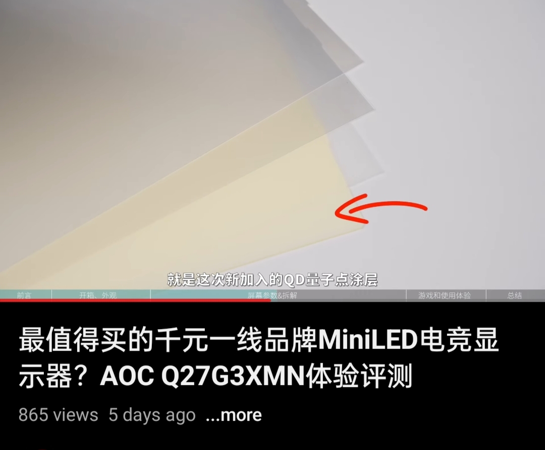

        But what’s the source of that image or for the claim made there? AOC hasn’t specified the backlight technology used (aside from what they’re calling ‘Mini LED’) and you’d need to do a teardown, measure the spectrum or observe for KSF phosphor flickering or fringing during strobe backlight operation to work that out.
        #74259
          It’s from that Chinese review https://youtu.be/cAn9UIIFa3M?si=MN1HLPaoVWB3BIb9
          #74262
            Ah I see now. It was difficult to interpret initially as my Chinese is a bit rusty, but it looks like he literally tore down the Mini LED modules and found 4 QD layers. That’s cool. 🙂

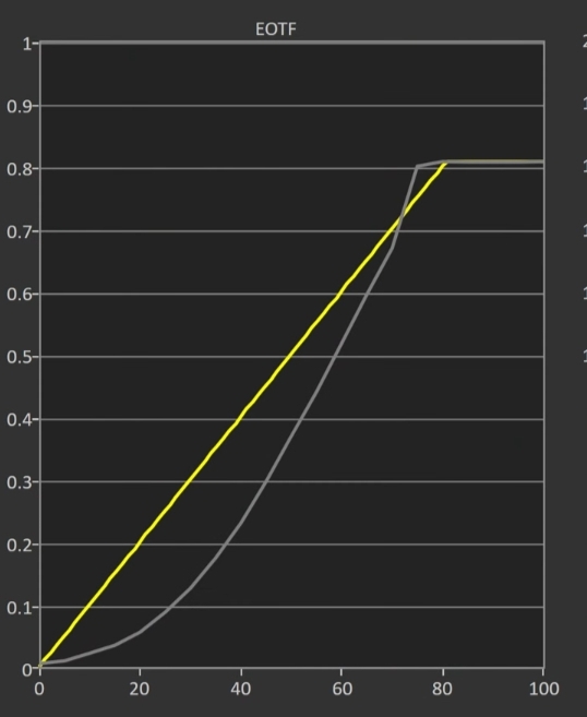

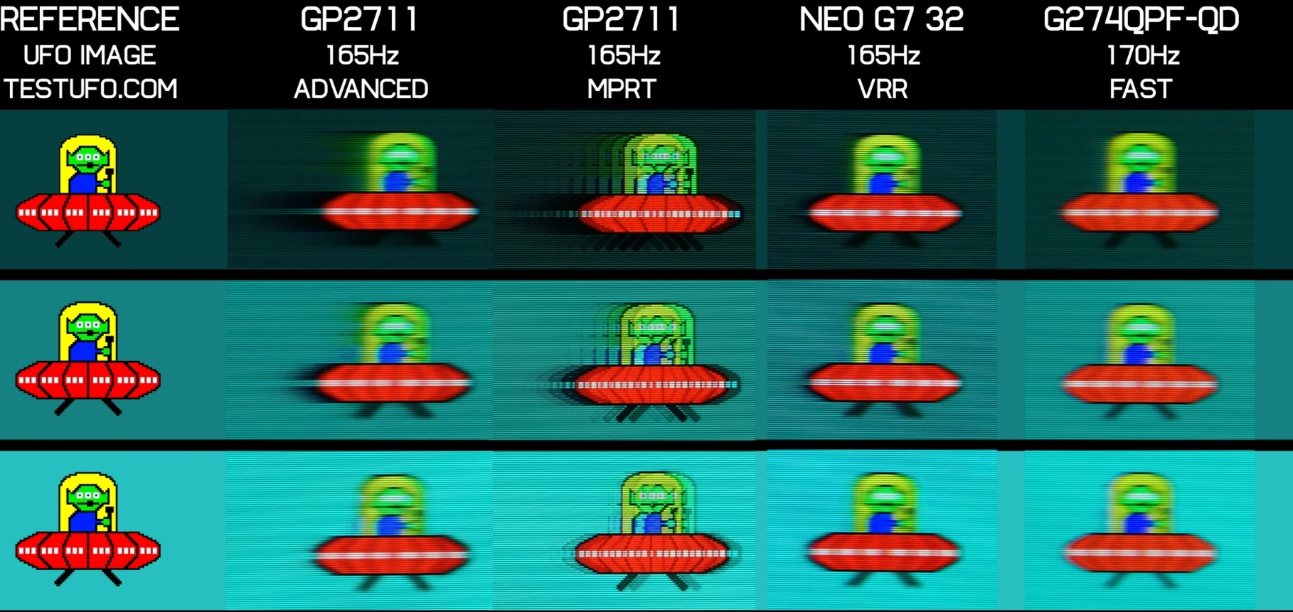

                                          Cooler Master Tempest GP2711 with 27″ 1440p VA Panel and 576-zone Mini LED Backlight is out, but unfortunately it has terrible black smearing.
                                          HDR is also unusable with this EOTF tracking:
                                          #75247
                                            Yes, it is indeed disappointing. Full review on Monitors Unboxed for those wanting to view all the gory details. Based on TFT Central the review currently in early access (will also be looking at it soon myself), the AOC Q27G3XMN is much better tuned.
