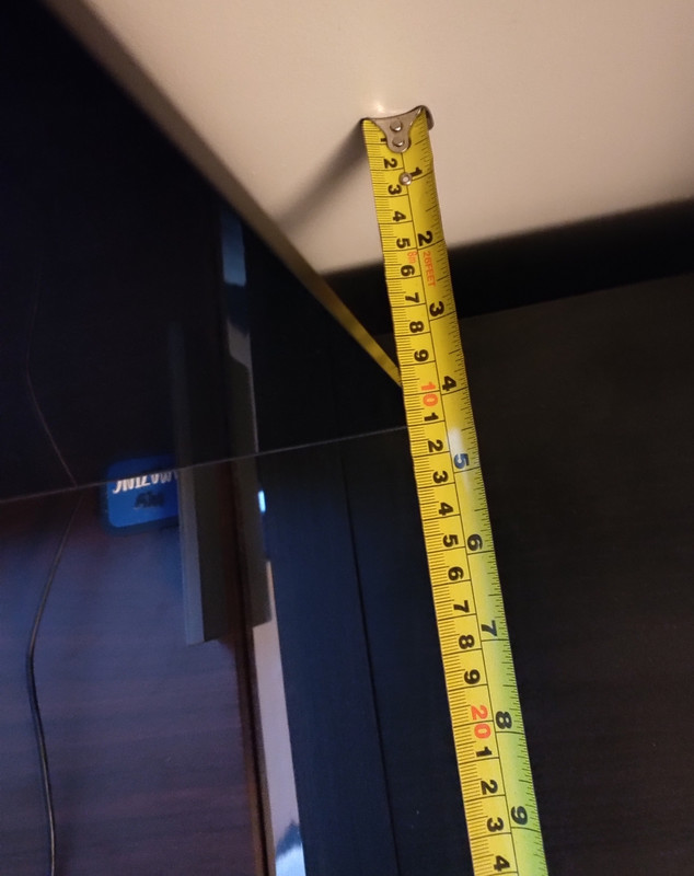

            Hi all. I ultimately went with the 42″ LG C2. The article does a great job covering all the differences so I won’t repeat them. I thought I’d add my perspective after using it for two months as my only monitor.
            Size:
            I have a 30″ deep desk and the TV sits all the way at the back of it. With my keyboard tray out I add another 5″ from the screen for a total of about 34″ inches screen to eye. I’d say the screen size is perfect for this scenario. It’s big but no where near overwhelming. I haven’t felt the need to adjust the height or tilt in my setup.

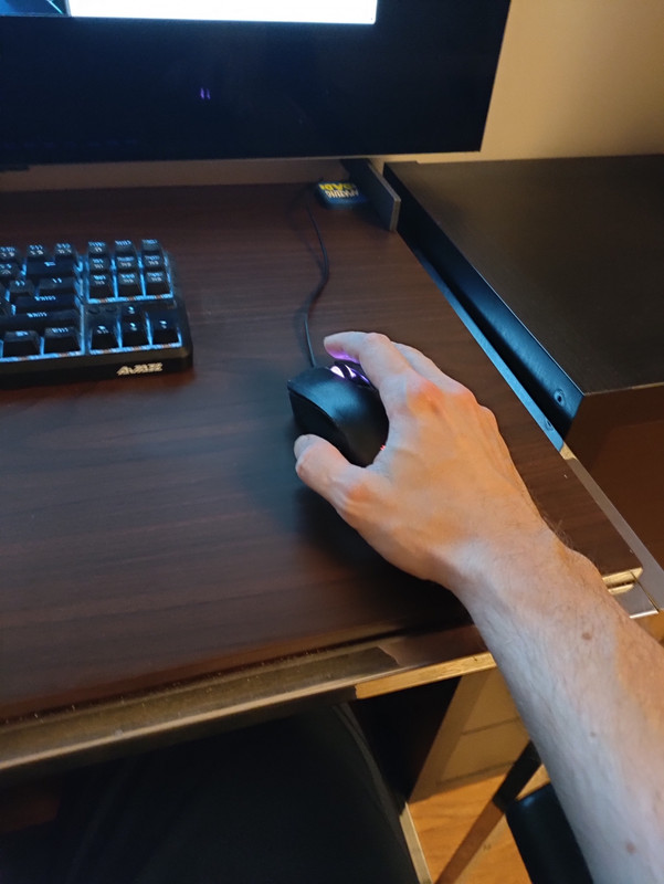

                    I actually have very small 100x55cm desk and still sitting 80-90cm from the screen.
                    How this is possible? First the tv stand is really nice and screen is very close to the wall.
                    https://i.postimg.cc/LsBHsZxV/IMG-20230113-203324.jpg
                    I’m also using chair with adjustable armrests so my hand is not very deep on the desk.
                    https://i.postimg.cc/G3zxy74W/IMG-20230113-202733.jpg

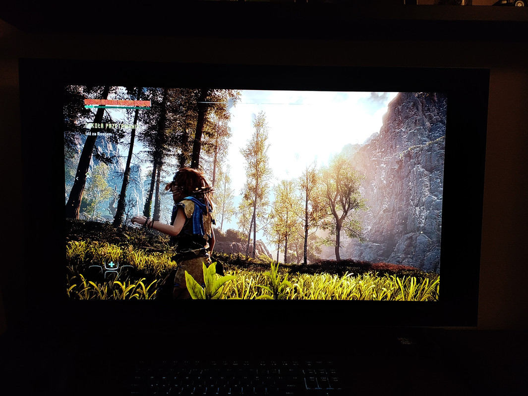

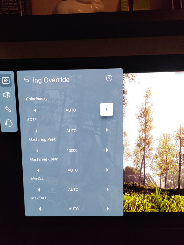

                    One more thing I wanna talk about is HDR tone mapping. With LG you have few good options:
                    Dynamic Tone Mapping on – I don’t recommend it for any purist
                    HGIG – best option for games that support it, or any hdr games that have max brightness slider
                    Dynamic Tone mapping off – this one is very useful for games that don’t have sliders.
                    For example HZD or God of War – these games pushing 10k nits on PC and with DTM off you can play with hidden menu (1113111) called HDMI Signalling Override.
                    https://i.postimg.cc/t4wmZXrv/IMG-20230113-210935.jpg
                    Here you wanna change Mastering Peak to match your game, so the highlights don’t clip.
