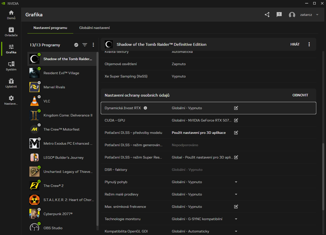

                    Isn’t it possible to use the option in the nVidia APP for game optimization, where the RTX DYNAMIC VIBRANCE item is? That way it would be possible to set it for each game separately :-).
                    https://i.postimg.cc/0NhgQTXx/image.png
                    Fortunately, I usually only play one game at a time, so maybe I can set it in INGAME and I won’t have to constantly re-set nVidia vibrance (it causes a problem after switching to SDR if I understand correctly).
                    #77333
                      When an HDR signal is detected, the monitor will automatically switch over into HDR (and “Display HDR” will be selected, if that’s what you were last using under HDR). So yes, you just enable HDR in Windows before entering the game. You might need to enable HDR in the game after doing that, or it may automatically run in HDR. Some games even have their own HDR toggle so you can toggle in the game itself and not need to bother with the Windows toggle. It’s a bit confusing, but it really depends on the game.
                      I believe RTX Dynamic Vibrance is designed to be used under SDR or if you’re using RTX HDR rather than the in-game implementation. Up to you whether you use it or not, but it isn’t the same thing as a proper HDR representation or increasing saturation alone using Windows HDR Calibration as suggested in the ‘Best Settings’ videos of AOC AGON OLEDs I’ve reviewed more recently. This is covered in the AG346UCD ‘Best Settings’ video, for example. It works better than Nvidia Digital Vibrance and only applies to HDR, I wasn’t aware it would work as it does when reviewing the AG276QZD2 which is why I didn’t cover it there.
