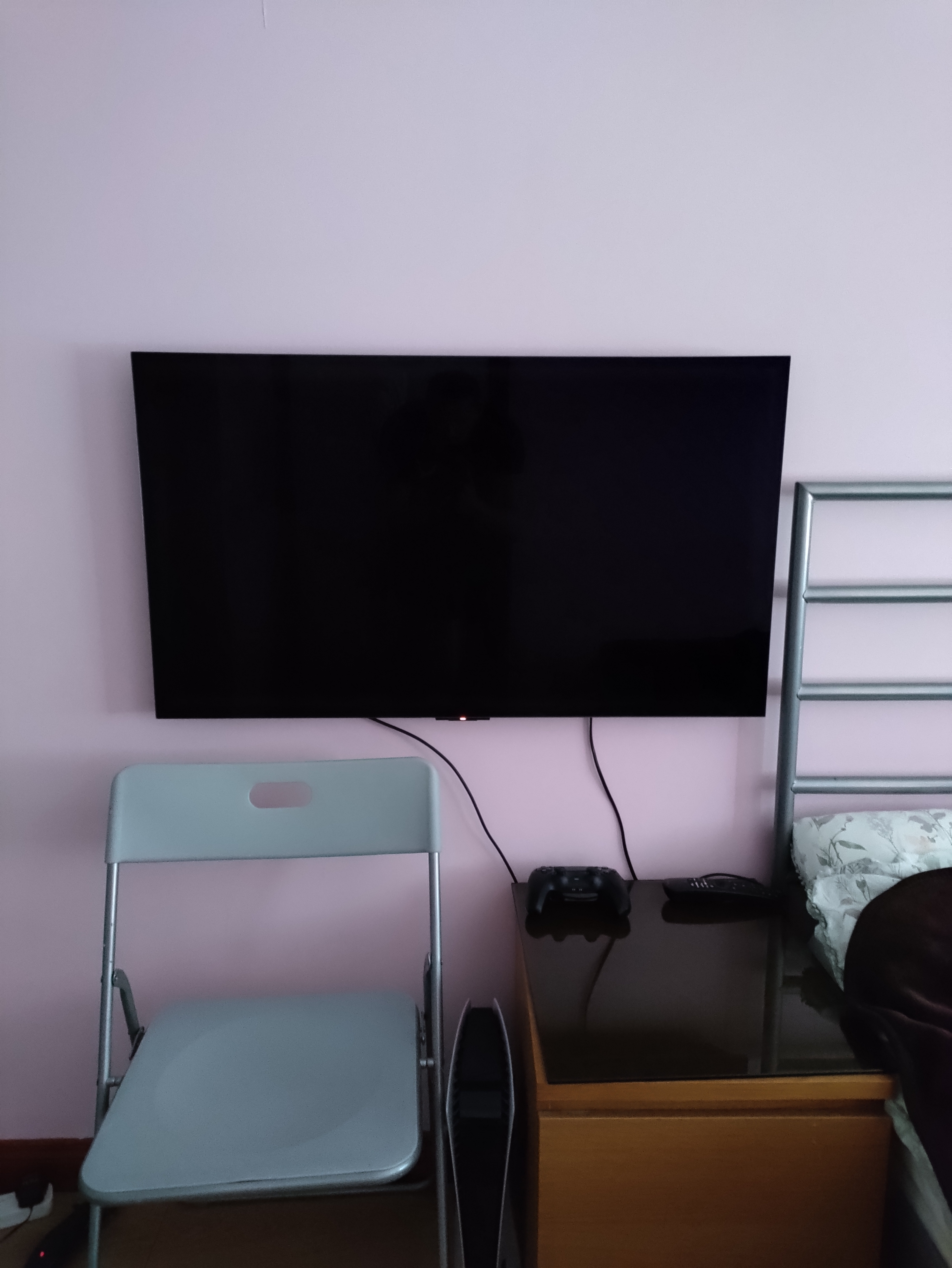

djkrisdeeOne thing that I don’t like on JOLED monitors is screen coating. Looks to me like semi-gloss on cheap LCD TV.
I’m big fan of glossy AG, but something like it is on LG C1/C2.I don’t understand why people buy OLEDs with matt AG coating.
Even in bright room with direct reflection still prefer glossy.
Matt screens only make sense in office.😉September 19, 2023 at 7:13 pm #74291
PCM2Yeah, I’m not fond of the typical JOLED screen surface either. It offers poor glare handling (invites more reflections or sharp glare patches than the QD-OLED models with their effective AR glossy treatment) and although it doesn’t ‘lighten up’ in quite the same way as QD-OLED in brighter conditions, it has a distinct blue cast to it there. Example vs. standard ‘light to very light’ matte surface on an LCD. It also has a bit of graininess to it, a slightly sandy texture when observing brighter shades that’s absent on glossy surfaces.
