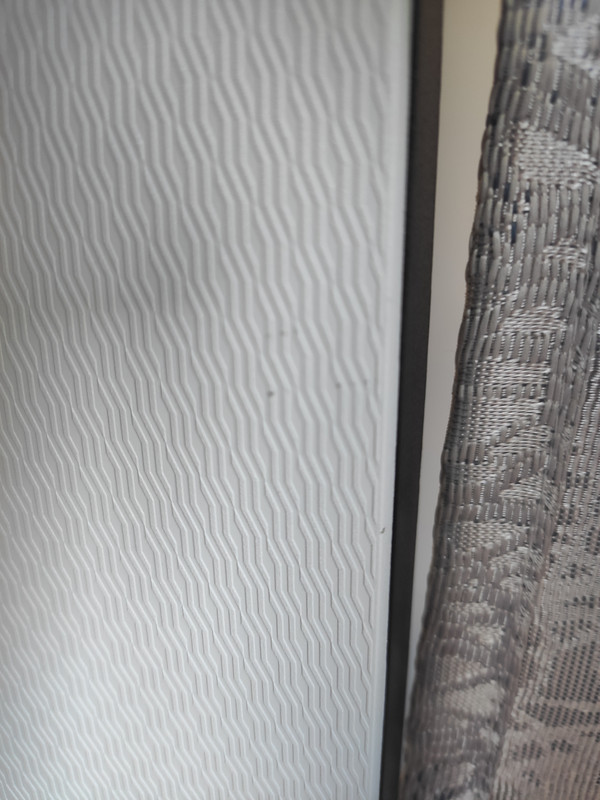

                                  Another thing: the back plastic panel had like some little imperfections on one spot. At least i think that’s what it is. It’s not scratched
                                  https://i.postimg.cc/VNHFLhtV/IMG-20220505-152125.jpg
                                  Think this is reason enough to return it?

                                    Glad you’re enjoying the S2722QC‘s cousin (S2721QS), overall. HDCP and splitters etc. really aren’t my area, but with HDCP it’s a handshake thing rather than something that affects quality – it will either get a signal or won’t based on that. As for the marks on the rear, have you tried rubbing them with a damp cloth? If they persist then I guess it’s up to you whether you’d want to return the monitor for that reason or not. If the rear just faces the wall and you feel you can just forget about the issue then I’d just keep hold of it.

                                      yeah, i tried
                                      actually, it had more. some have come off, others didn’t. it’s not a huge deal, just a minor gripe.
