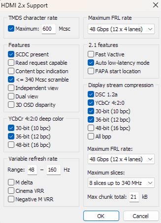

          I’m not sure if Gigabyte simply copy + pasted that from the M27U (which had limited bandwidth HDMI 2.1 ports). Because the M27UP has full bandwidth HDMI 2.1 ports, so I don’t see why they’d have that signal limitation. The PS5 supports 4:2:2 only at most for ‘4K’ UHD on any monitor so the bandwidth is always limited to an extent, but the M27UP should be able to support that rather than being limited to 4:2:0 for bandwidth reasons.
          Either way, I wouldn’t worry about it if it does happen to only support a 4:2:0 signal. This is what I said about that in the review of the older M27U:
          “The HDMI 2.1 ports of this model offer a bandwidth of 24Gbps with DSC (Display Stream Compression) used to extend its effective bandwidth further. For example, enabling Full Range RGB or ‘4:4:4’ without chroma subsampling at the maximum refresh rate. Unlike many PC GPUs or the Xbox Series X, the PS5 doesn’t support DSC – so it would require a higher uncompressed bandwidth for its maximum supported ‘4:2:2’ signal for ‘4K’ UHD @120Hz. As that isn’t available here, a ‘4:2:0’ reduced chroma signal is instead used for ‘4K’ UHD @120Hz on the PS5. In practice this works very well for ‘4K’ gaming or movie content with minimal visual impact in either SDR or HDR. Many people would struggle to see a difference even with a direct side by side comparison, so it isn’t something we’d worry about.”
