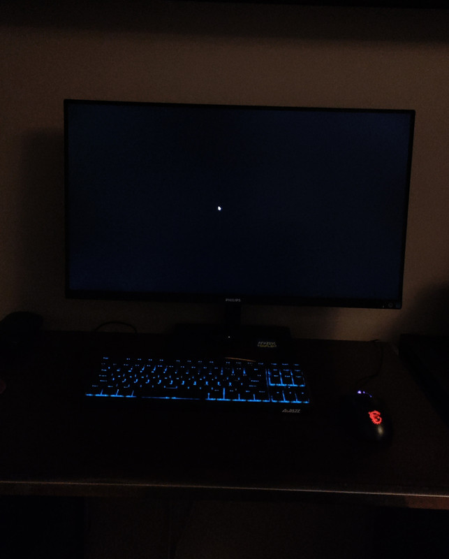

              I found this Chinese review but it has some crazy readings like 4878:1 contrast, and black smearing is actually massive at 100Hz.
              I was thinking about buying this monitor after Amazon cancelled my Iiyama order, but end up ordering AG275QXN/EU.
              Black uniformity is very important for me, and I don’t believe its possible to have that on edge lit curve screen.
              Even my 288E2E have good black uniformity, especially for IPS panel.
              100 cd/m²
              I’m generally very happy with this Philips, but I want more contrast.
              Expect plenty of UFO pictures next week. 😝
