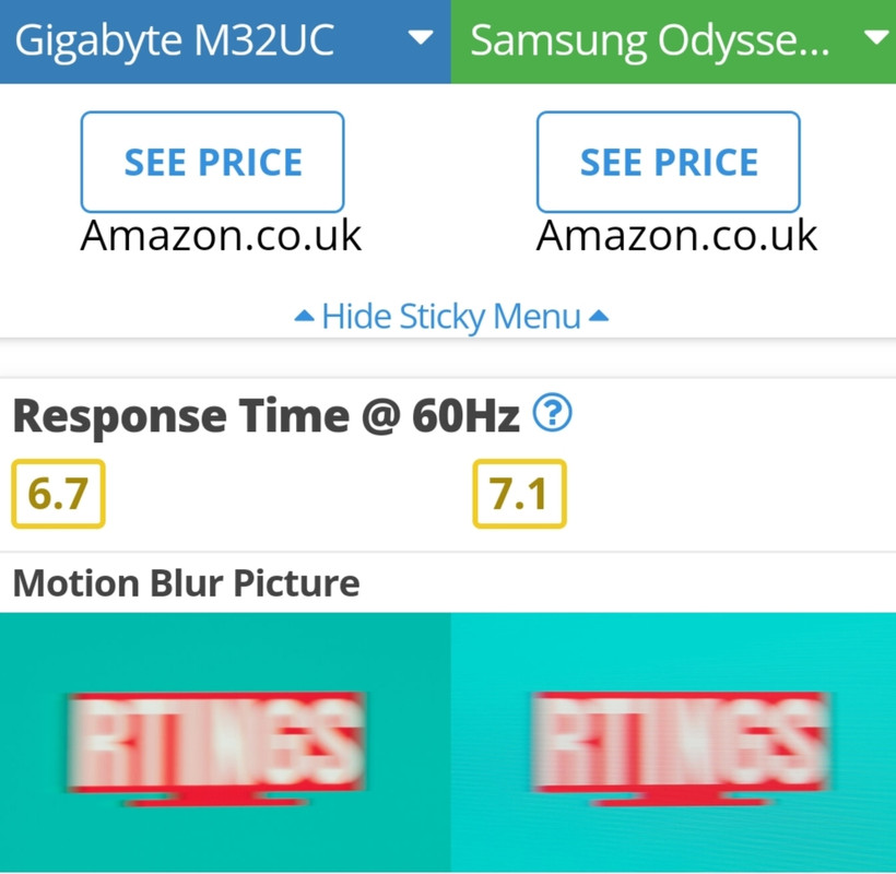

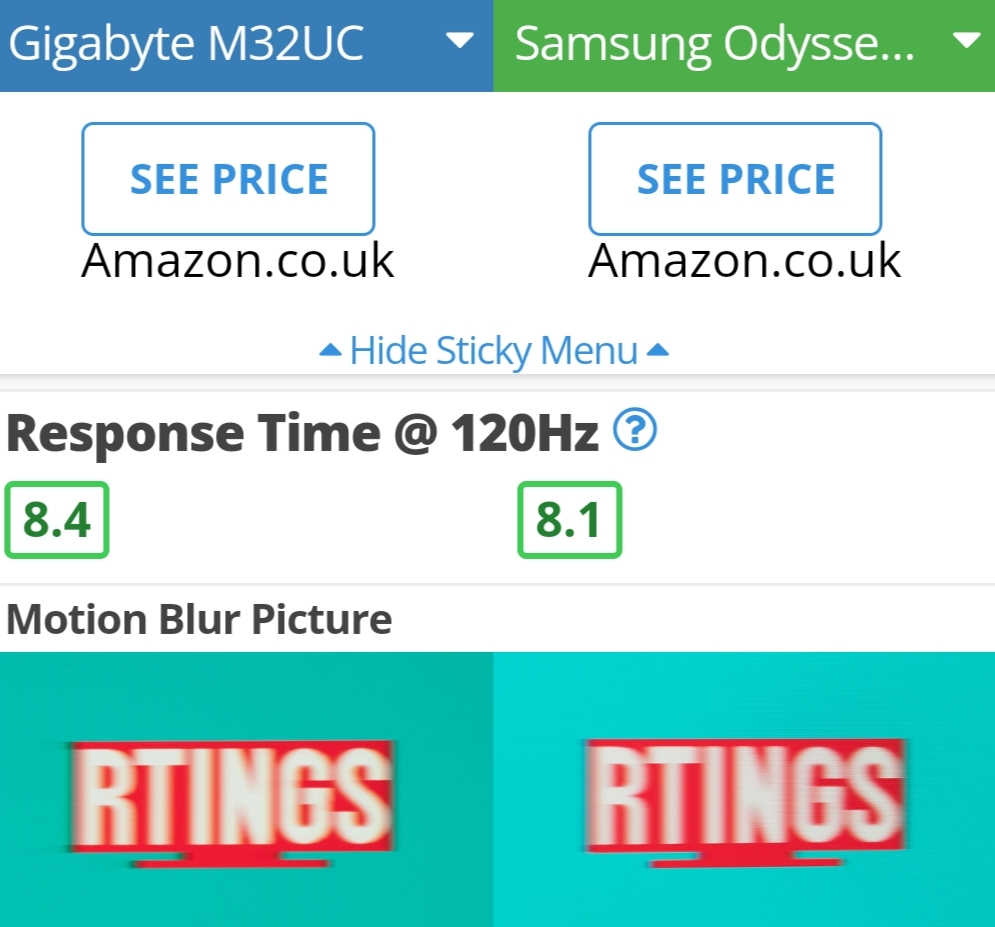

              Looking at Rtings comparison of M32UC vs Odyssey G6 at 60hz and 120hz Gigabyte monitor doesn’t have terrible black smearing?
              M32UC vs Odyssey G6 60hz
              M32UC vs Odyssey G6 120hz
              One thing I’m worried about is that AG325QZN may have overshoot @60hz because even with overdrive disabled, the panel achieves a response time of 6.94 ms.

                The RTINGS pursuit photo is very limited in the range of transitions it shows, the background is nowhere near dark enough to show the clearest VA weaknesses. Nonetheless the M32UC is a decent performer and as such a bit of an improvement over that puts the AG325QZN firmly in the “decent to good VA performance” camp. I agree seeing for yourself and returning if not satisfied would be a good solution. 🙂
