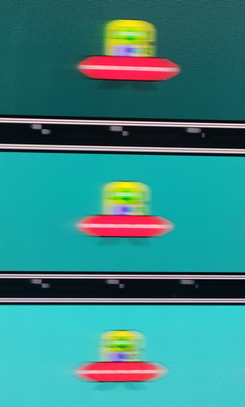

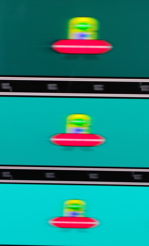

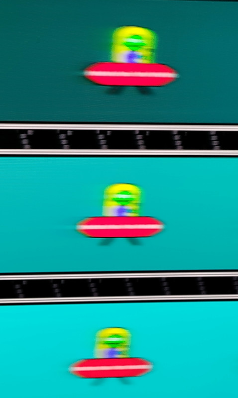

      I would like to share my experience gaming on Sony 55XH9505 4K 1200nits FALD TV from 2020.
      Most people probably thinking VA TV? It’s going to be black smearing fest, but this panel is actually faster than my Philips 288e2a 4k 60hz IPS monitor.
      UFO motion test, 60Hz
      Colour space:
      sRGB
      DCI P3

      I know it’s only 60hz, but still in my opinion sRGB looks on par with fast IPSs and better than the 288e2a.
      P3 looks faster than the Neo G7!
      And BT.2020 dark background close to Neo G7, but medium background definitely faster.

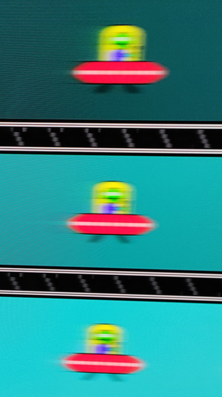

      1080p 120Hz sRGB

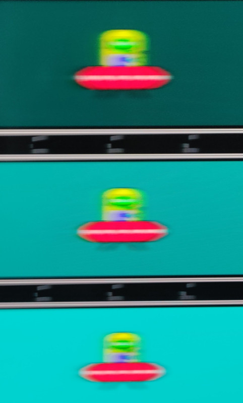

      1080p 120hz DCI P3
      Sorry for not the best quality of pursuit photography, but i used £200 mobile phone.🤪
